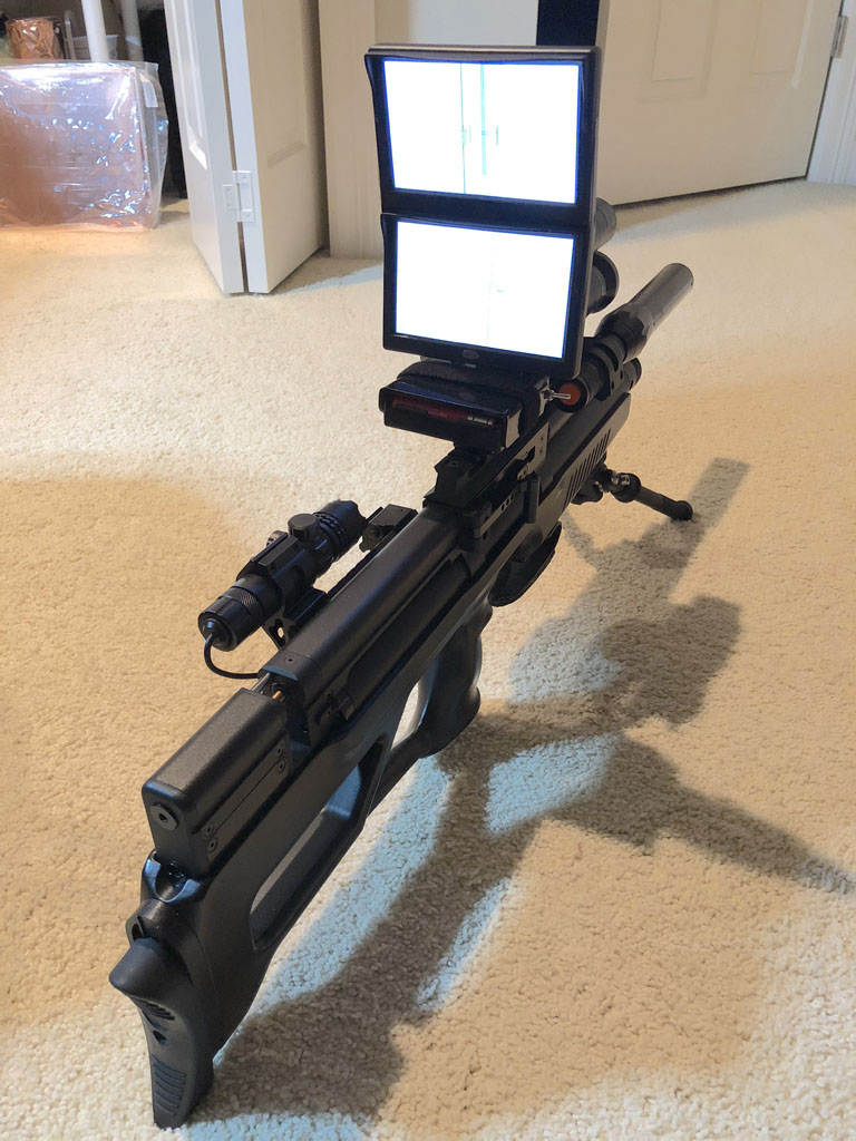

    Sorry, the Photobucket debacle clobbered some images permanently.
    I have managed to recover some and host without Photobucket
    Current build has two screens for simultaneous viewing of targeting and spotter cameras.
    OWL camera was replaced with a 2nd EJ230. That allows crosshairs in both spotter and targeting views.
    Also, the IR laser for indicating holdover has been very effective. I simply tap the laser button and where the laser appears on the screen indicates my needed holdover for things < 25 yards. From 25 to 40 yards, I can just aim center cross hairs and hit the quarry. It’s really in the closer ranges that the laser makes things easy and fast. Ranges and indicates required holdover in a fraction of a section.
