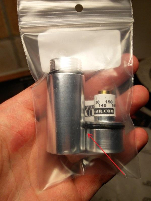

    Member
    Can someone explain me how the regulator is vented to the atmosphere? I know it is vented through threads but I cannot imagine what is the air path. Can someone create a diagram?
    #263522
    wingman-nz
    Member
    quote shooter3:
    The red arrows show the breathing path for the washer stack
    #266027
    shooter3
    Member
    Thanks for the diagram. I have one more question. Is there a breathing hole in the regulator like the one in Huma?
    #266032
    wingman-nz
    Member
    No it just breaths through the thread
