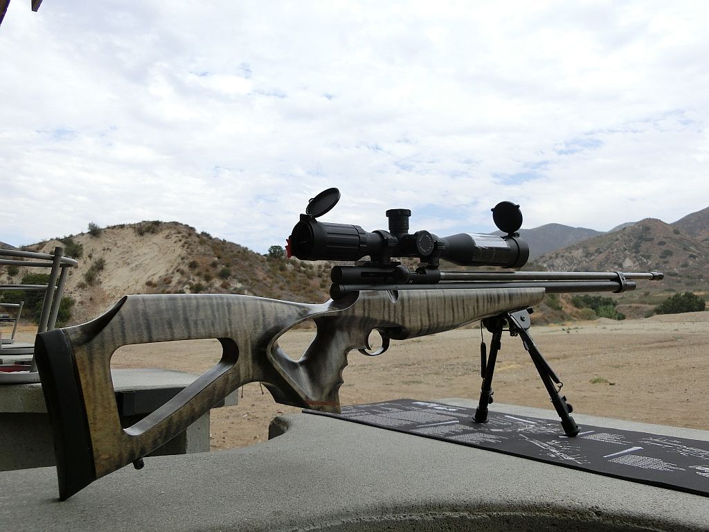

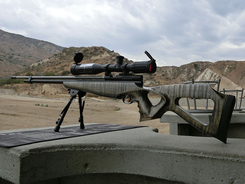

    The 1st outing with the Corsair+ 7mm was very positive. As some might remember, the gun was due for and upgraded barrel even though it just got a new barrel….lol! The switch went from a TJ 7mm barrel of 1-14 twist to a TJ 7mm barrel with 1-10″ twist. Even though i’m shooting sorta light bullets in the caliber, the bullets are long. The 7mm 130’s are about as long as many of the 308 cal 150+ gr bullets.
    The bullet of choice out of the 4 I have are the 120+ gr LBT fp’s. These are the bullets I’ve been rooting for and they came through. Oh yeah, and so did my machinist Doug Noble.
    More to come so………

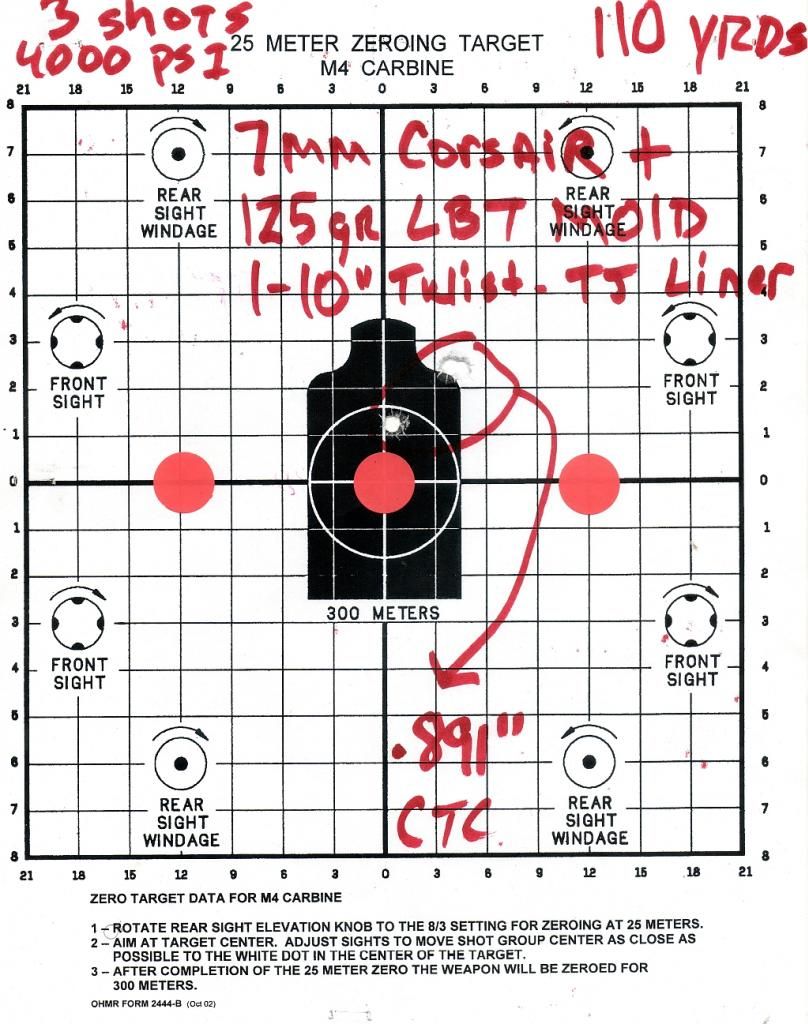

    About time for another video, 110 and less than an inch. Good Shootin Pardner.

    Thanks MAW. I can’t wait to get the reg setup for my SCBA tank. Hoping groups shrink by a ton.

    Barrel length and fps for the three shots above please. Thx

    BEBTM,
    This gun is PURE HUNTING built. I can get 2 shots back to back within only a few FPS. The 3rd shot really drops by like 40+ fps. But I don’t care about the 3rd shot dropping like that cause I fully understand the build of the gun. The start of a good shot count is in the size of the airtube or bottle. This gun has a puny airtube. For longrange plinking and target shooting, the gun gets TETHERD so shot count doesn’t matter. For hunting purposes, I have 2 shots that are dead on, after that, If I still missed, I SUCK not the gun….lol!
    The barrel is 30″ long and it shoots 120 gr HP’s at 890 fps when tethered at 3000 psi

    I really hoping to get part 2 of the 7mm video filmed soon. I’m trying some 20-1 cast bullets now instead of pure lead. I’ve got some unanswered questions/problems with my favorite 7mm mold and i’m hoping the 20-1 helps with this issue.
    If so, I expect groups to shrink.
