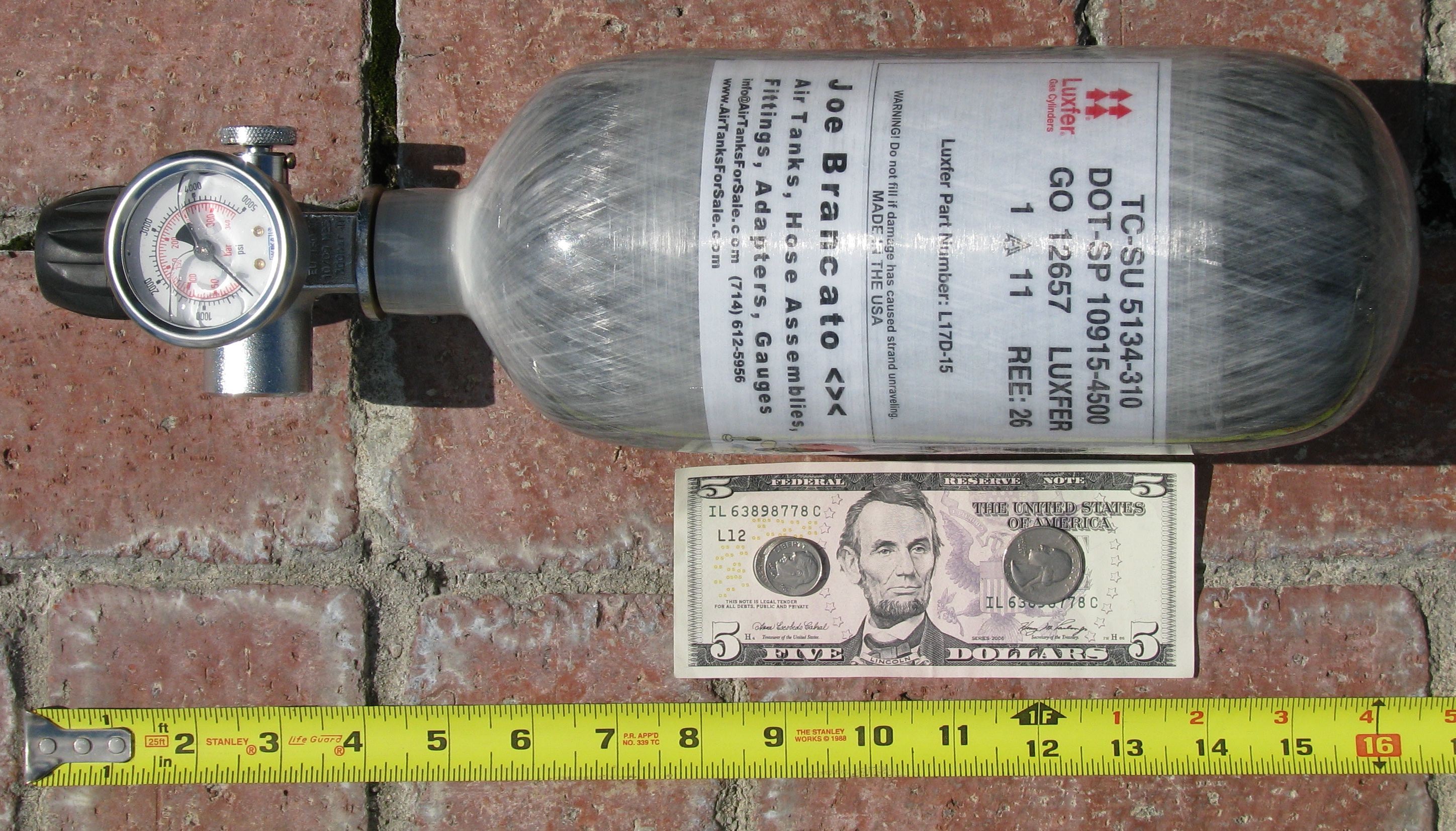

    mughram
    quote Cricket:
    Got mine, very high quality :8:
    could you please make same as this picture in measurements
