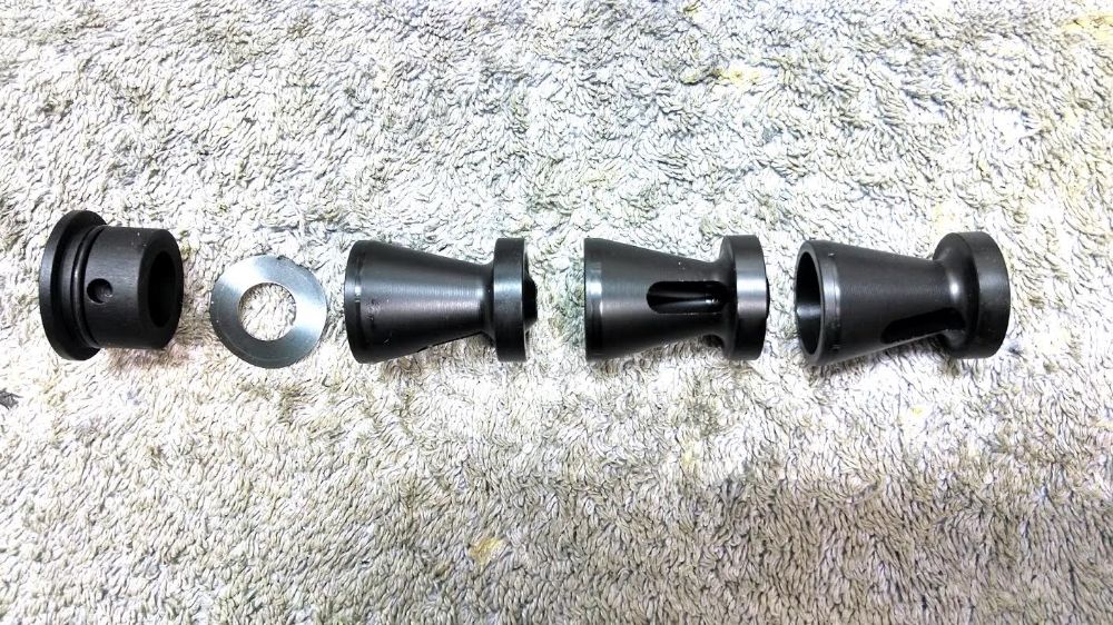

    Make sure the baffle stop screw is in. Then drop baffles in this order…

    anthony266
    Keymaster
    This is out of a factory CondorSS…it is also same as the sound lock system, except for the spacer.
    What do your baffles look like?

    gan1hck
    Member
    Interesting…on my Condor SS which I just bought, all of the baffles are exactly the same.
    Wonder why ?
    Tony,…you think my baffles were not assembled properly?
    #217299
    genet
    Member
    They’re supposed to be the same – he’s just showing the left-to-right orientation.

    #218048
    jca245
    Member
    This might be a stupid question, but does it make any difference as to the position of the slots milled in the side of each baffle?
    Should they line up or be staggered ?
    Or does it really make a difference?
    Personally I do not think it matters, but I figured I would ask just in case.

    gan1hck
    Member
    I don’t think it matters….Ive played with mine a bit…does not appear to be a difference in noise level

    birdman
    It’s the same baffle set up with the Talon SS . However , I kept getting pellet clipping with the metal washer . I solved that problem by
    removing the metal washer and replacing it with a standard water hose rubber washer . No more clipping and with Tony’s 9″ LDC added
    to the barrel of my Talon SS , I have a very accurate and backyard friendly rifle . Shooting EJ’S 35.8 gr. pellets at 37 yards is a one shot
    one kill sniper perfection piece of weaponry .

    Member
    i read on the above post that said make sure the baffle stop screw is tight. can you adjust how far down the baffles can go . can you lower the baffles a little more down so you can install a shroud ? another words can you use the stock baffles with an aftermarket shroud ? can you use both systems in the gun?

    wll2506
    Member
    Does the flat head screw in the bottom rail of the SS go just ahead of the last baffle ? Being there is no parts drawing, who knows ?
